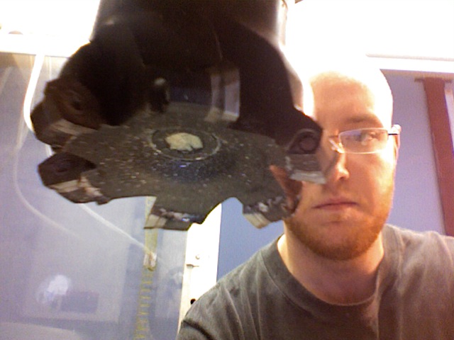

For what it's worth, I think a helical insert planer could probably handle it, especially in hardwoods, but there'd be no point compared to using a thickness sander besides maybe the 'planed vs sanded' surface.
If you want to talk about 'new school' and 'old school' I think old school is the hand plane, middle school is the Wagner and thickness sander, and new school is vacuum clamping stuff down and then thicknessing with this guy:
It's covered in aluminum because I made my first part in alu today (yay) but it's wonderful for just about anything. It makes chips rather than dust and leaves a shiny planed surface on both wood and metal.
